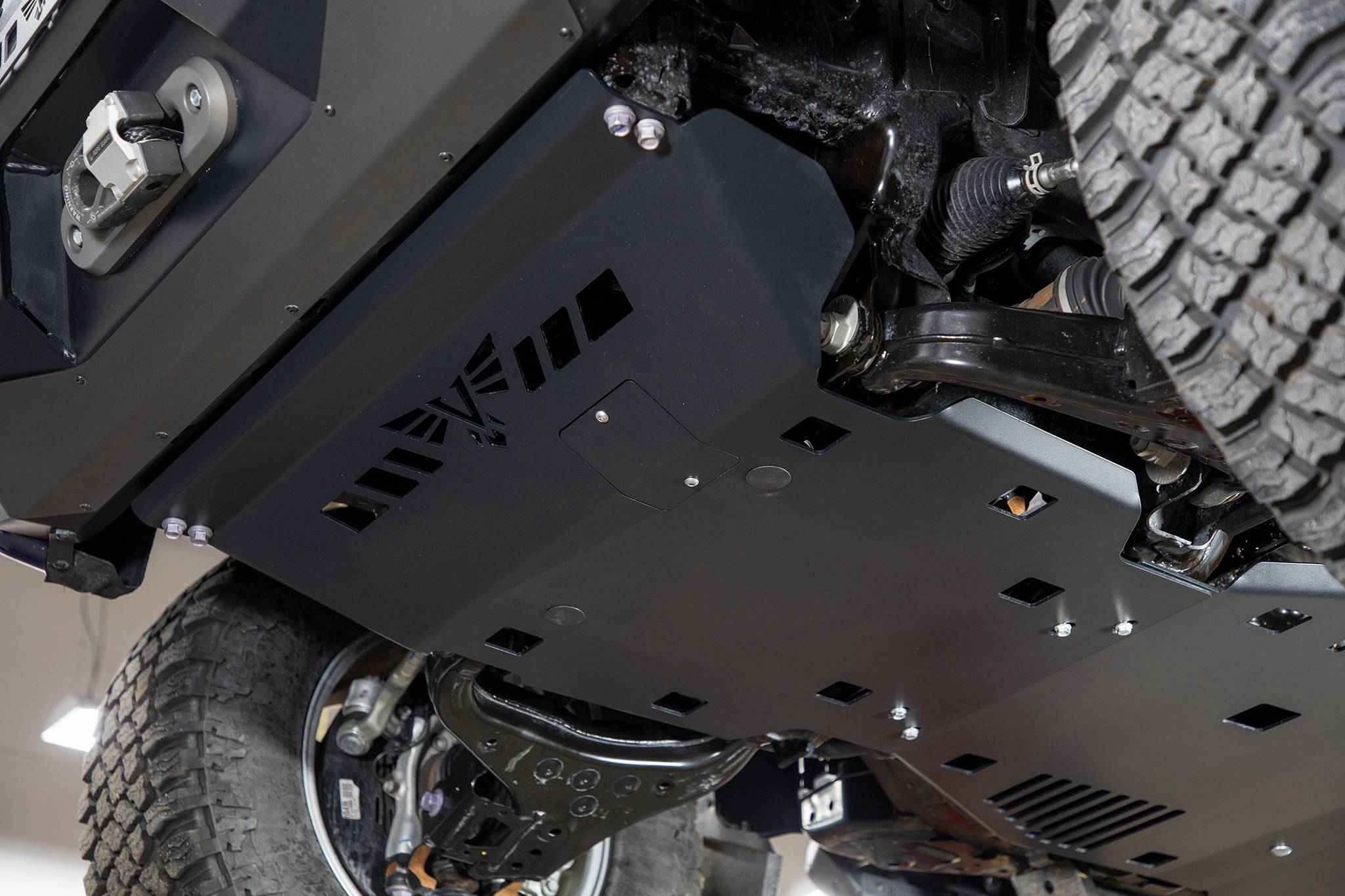

I am waiting for my Victory 4x4 front stand-alone skid plate. They put it on their TRD Sport.
I talked with their tech and it uses the 4 bolts where the retrieval points are located and the other 4 in the rear in the image. I will verify using the factory 4 front bolts when it arrives soon.
Front skid plates are a must with any 4x4 to protect lower front half of engine and cooling package, plus when looking at my naked lower front end, it will slightly improve air flow underneath instead of getting disturbed by lower control arms and exposed cross member, etc..

I had a question about the Victory skid plate you ordered.
If they use the retrieval point bolts can you still put the retrieval hooks back on over the skid plate once you mount it? Looks like they did.

Victory 4x4
Daryl
Feb 14, 2024
153
256
Portage, MI
'24 TRD Pro
Yep, sure can.
