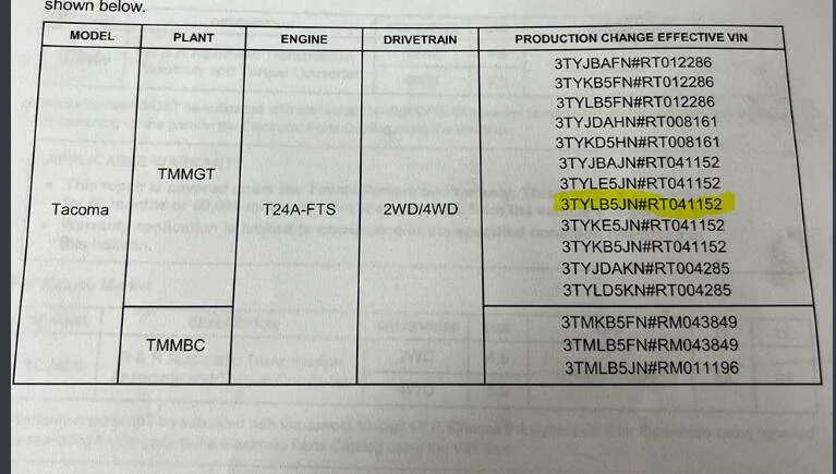

Looks like my TRD Sport that I got in April falls in this range. I've already taken it to the dealer once about hard shifting and they said it's "normal behavior". At what point do I take it back? Do I have to wait until it fails completely and they have to come tow me?

How can you tell?
Because the first eight numbers and letters in your VIN# match the one that's highlighted. and then the last six numbers in your VIN are less than 041152.

Whew!!! 3TYLF!!! Not included. I was very afraid with an extremely low number at the end d of my VIN.

Same question, because I'm not sure which VIN to compare mine with. Mine also starts with 3TYLC5 and my last six digits are 005347. But there are no 3TYLC5 VINs in that list. So how do I determine if mine is in or out?
My VIN starts the same. I think that means we aren’t in the TSB.

Which factory?

How can you tell?
Gary, I have attached a screenshot of the range of VIN's that your Tacoma is in. Underlined in Yellow is the VIN prefix, yours (And Mine too!) Underlined in Red is the number where the recall stops (041152). So if the prefix matches and and the last six numbers are higher than your last six numbers, you are in that group, Like myself.

I say that since your VIN is in the TSB range and it has shifting issues you take it to the dealer ASAP.
